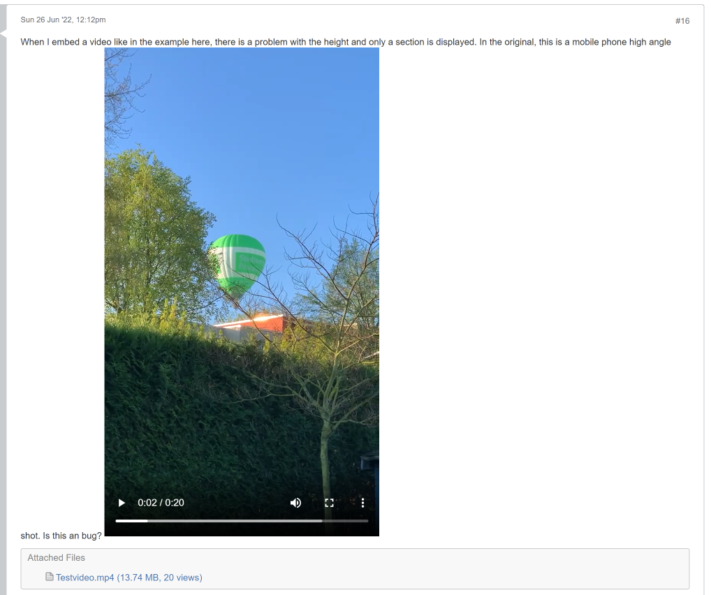

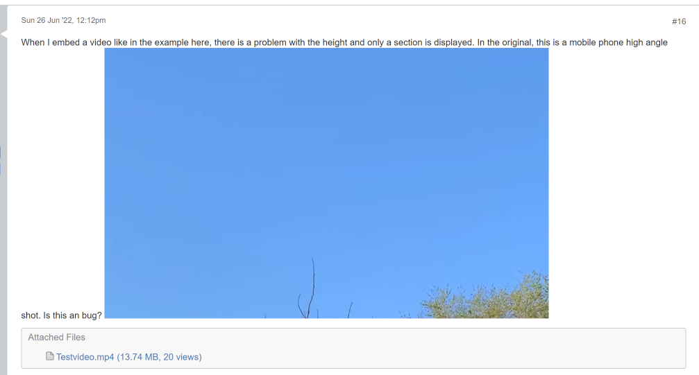

    Starting vB 5.6.8, video attachments render in HTML Video player but the default size implemented by vB is just tailored for videos in landscape mode. Thus in portrait mode, the video is cut off and the video controls are not visible. Please refer to this post for more details.
    Click image for larger version  Name:	portrait-video.png Views:	233 Size:	73.6 KB ID:	25125
    To fix this issue, add this custom CSS in css_additional template:

    Click image for larger version  Name:	portrait-video-fix.png Views:	54 Size:	461.1 KB ID:	25126
    Enjoy!
    EDIT: This has been officially fixed in vB 5.7.0. You no longer need the custom CSS fix here. If you've already added the code and you have upgraded to vB 5.7.0, then you can remove the code.
