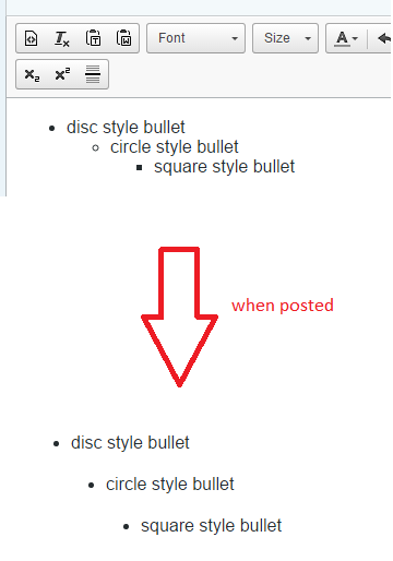

    There are issues when you use nested bullets in the editor. See screenshot below.
    To fix the above issue, add this in css_additional or via Sitebuilder > Style > CSS Editor.
    .restore ul, .restore ol {
        margin: 1em 0;
        padding: 0 40px;
    .restore ul ul, .restore ul ol, .restore ol ul, .restore ol ol {
        margin-top: 0;
    .restore ul > li {
        list-style-type: disc;
    .restore ul ul > li {
        list-style-type: circle;
    .restore ul ul ul > li {
        list-style-type: square;
    That should fix the issue as shown below which is not an image but an actual lists as I applied the fix here in this forum.

    I was not even aware this was an issue until I saw this post.
    The fix works
      I wasn't aware too until someone posted the issue and asked for help in the vB support forums. I first posted the fix there then posted here.
