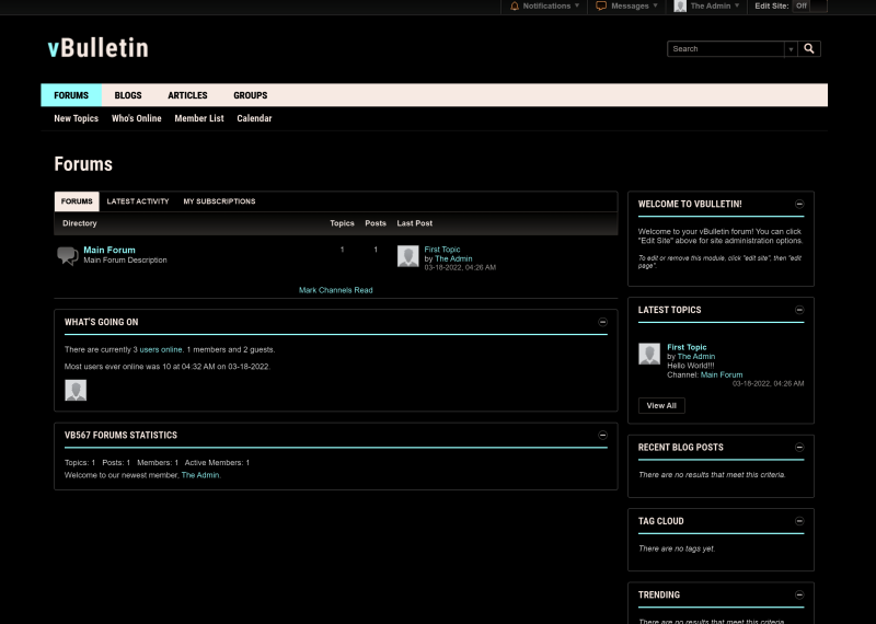

    Here's how it looks like for the vB5 Default Style when using this mod.
    Click image for larger version  Name:	vbulletin-dark-small.png Views:	0 Size:	337.0 KB ID:	23634

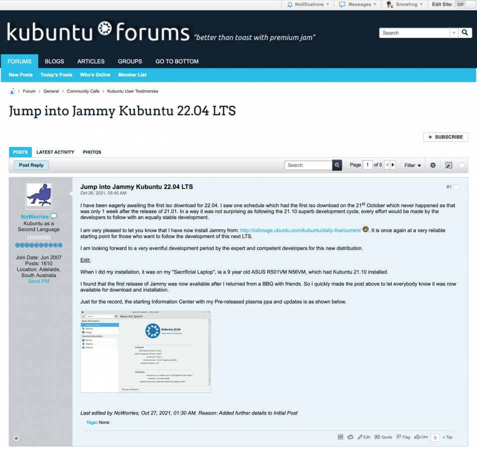

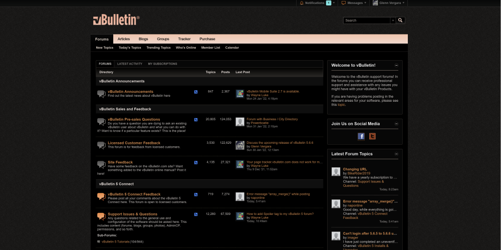

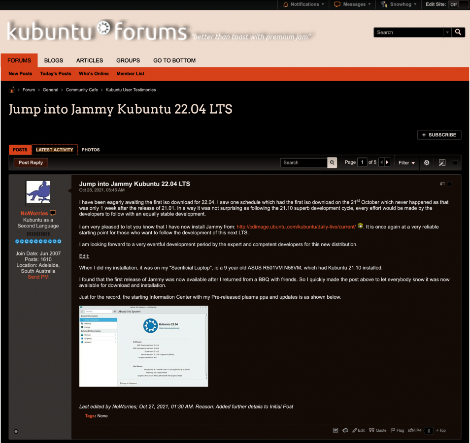

      Try the "Invert Color Theme Test" script on your forum and post a screenshot of it for us to see how it looks like on your site.
        Before:
        Click image for larger version  Name:	Screen Shot 2022-02-05 at 9.16.02 AM.png Views:	0 Size:	718.7 KB ID:	23647
        After:
        Click image for larger version  Name:	Screen Shot 2022-02-05 at 9.15.40 AM.png Views:	0 Size:	687.6 KB ID:	23648
          Nice! You can skip inverting the color of the logo by following Step 14.4. Maybe it would look better with inverted color.

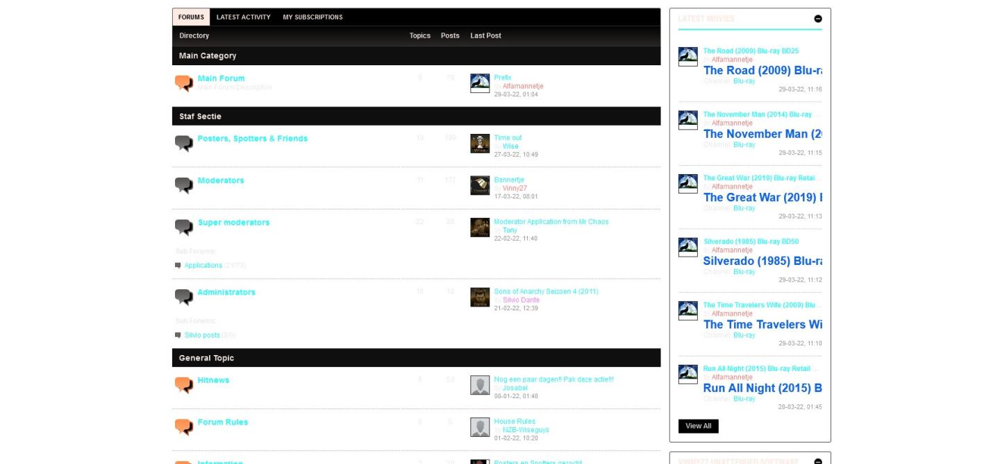

                With me, it does this:

                        adama, I got your PM. I can confirm that this does not work on Firefox. Firefox does not support CSS Backdrop Filter by default. There is a Mozilla bug report for this. Per MDN browser compatibility chart, it says that you can manually enable CSS Backdrop Filter on Firefox by enabling layout.css.backdrop-filter.enabled and gfx.webrender.all preferences (set both to true) in about:config (navigate to it in the browser address bar). But when I enabled them the auto-dark mode still doesn't work.
                        I will check further if there's a solution to it.
