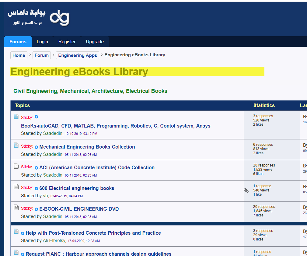

    If you could show me a photo of the exact location, I could write you a condition.
      Here it is

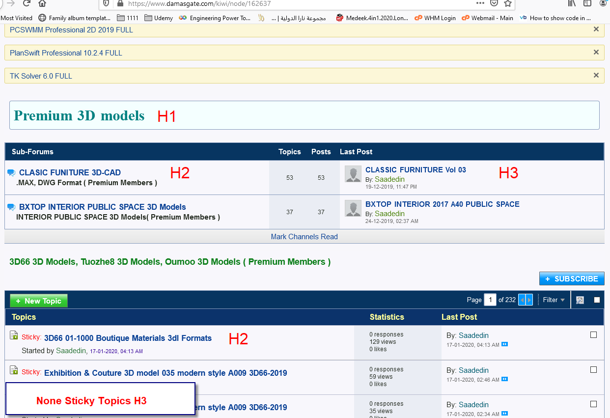

          I need to display forum title at the top of all topics list pages ( above subforums list too )
          I use this code but not show up with the plugin I created.
          <h1>{vb:raw title}</h1>

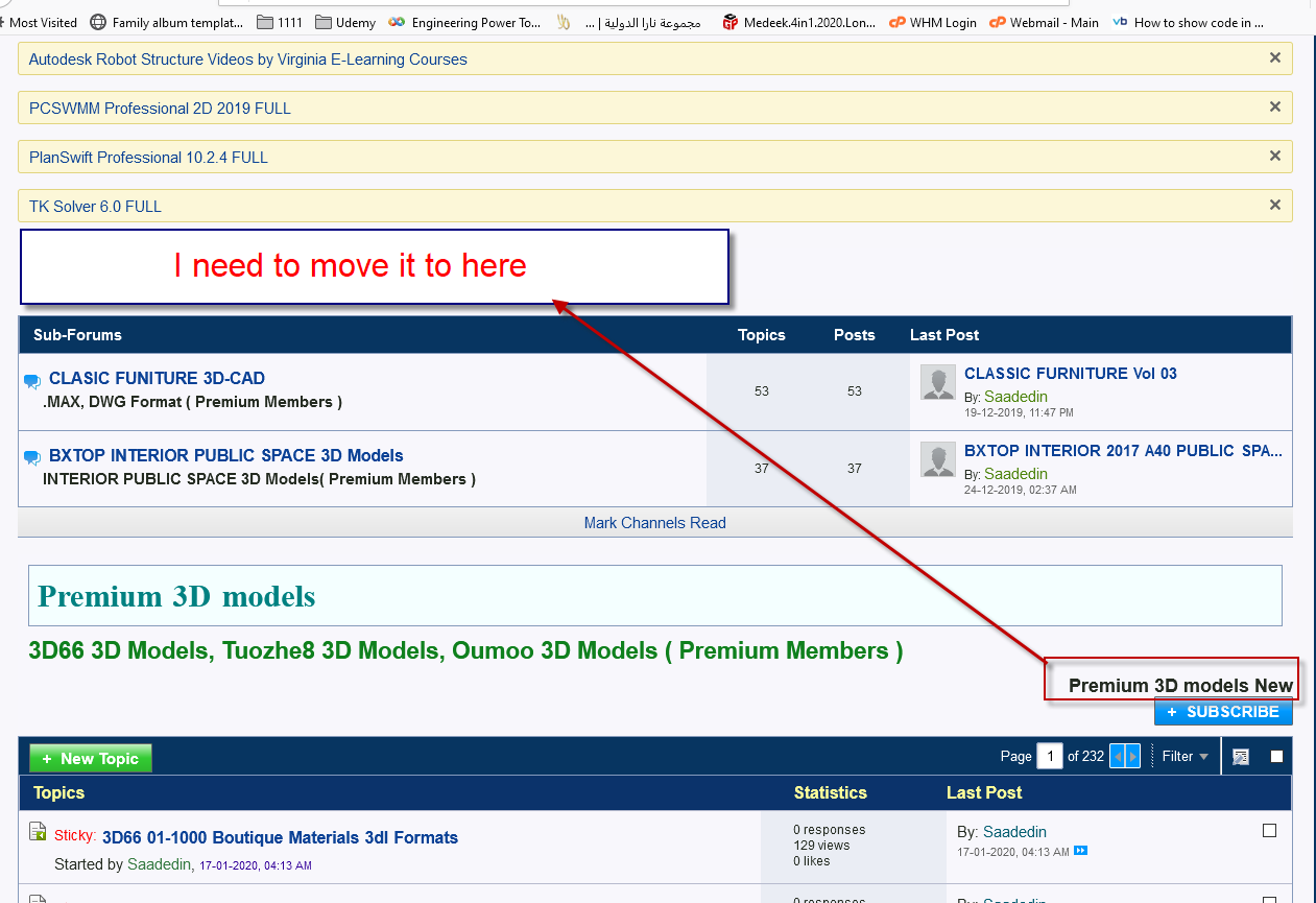

              Click image for larger version  Name:	seo.png Views:	0 Size:	96.6 KB ID:	21683
              Very cool and it appeared with the required pages but I want to raise it to the top of the page, Above Sub-Forums list.
              Reason: The H1 heading must be at the top level of the page for good SEO.
              I appreciate your help.
                I'm afraid that right now this is only possible with Option 1 but there are several other methods that require custom coding.
                For example, you could put your template directly in any of Display Templates using this method {vb:template yourtemplatename}.

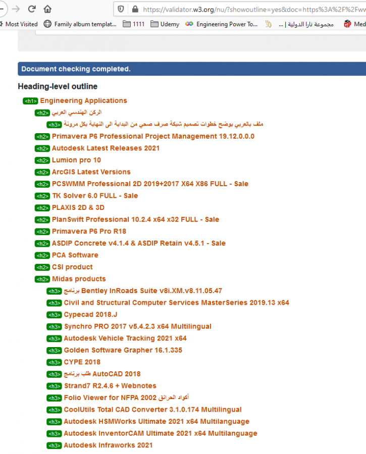

                    This result is now
                    I love it
