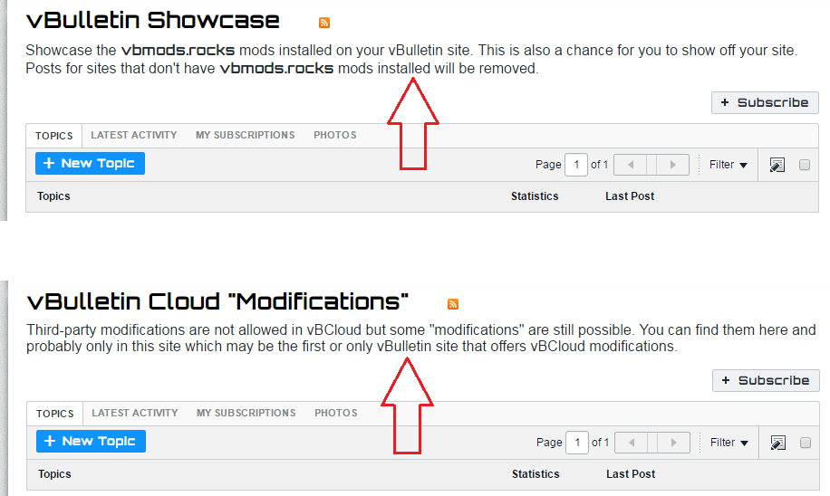

    Screenshot:
    See any forum channel page on this site.

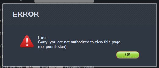

Name:	No Permission Error.PNG
        I get this message when trying to install this code in the ad module.
          Are you on vBCloud?
        Yes, I'm on cloud, so this doesn't work for cloud forums?
          It should work. Can you try reloading the page and try again?
            I get the same message when refreshing the page. I don't understandstand what i did wrong.
            • Nintenex
              It allows me to save it without the <vb:literal> codes though it doesnt work correctly.
              It looks like the workaround to add <vb:literal> tags doesn't work in vBCloud and only works in self-hosted version. You're out of luck then. But I heard forum description will be implemented by vB soon. So I guess you just have to wait.
