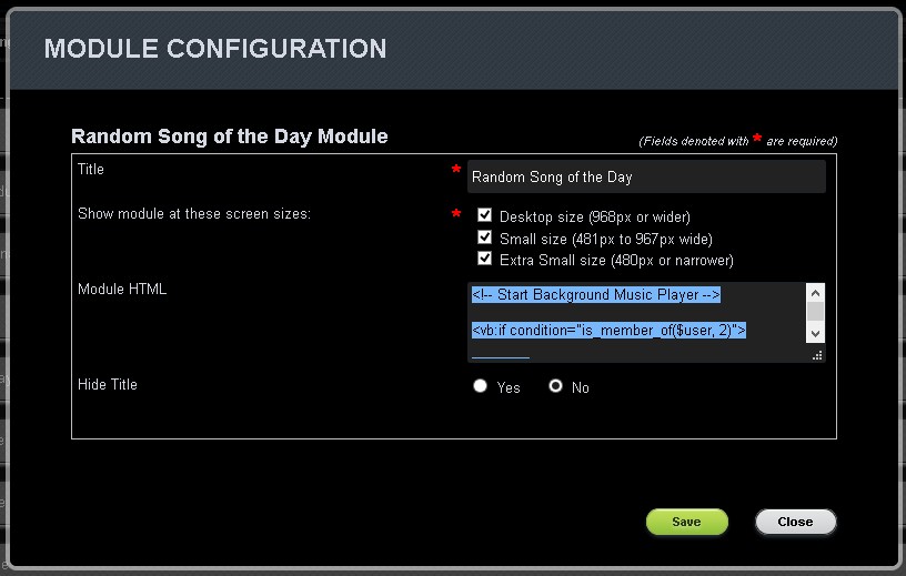

    Activate the Site Builder
    Add a Static HTML Module
    Edit the module
    Add this code.

    Save and reload.
    The player will look slightly different in various browsers.
    This is how it appears in Firefox.
