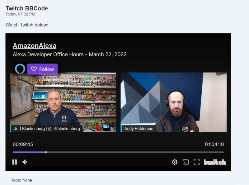

    Example:
    [twitch]1433394436[/twitch]
    Output:
    Click image for larger version  Name:	twitch.png Views:	0 Size:	278.2 KB ID:	24488
    You can also use Video ID, Channel/Username, or Clip ID inside the Twitch BBCode tag.
    To add clips, you need to add all characters after "/clip/" in the Clip URL and before "?" if it exists. For example, if the Twitch Clip URL is https://www.twitch.tv/myusername/clip/MyClip-UlQu2NyjJ1pbfKGa, the BBCode tag would look like this:
    [twitch]MyClip-UlQu2NyjJ1pbfKGa[/twitch]

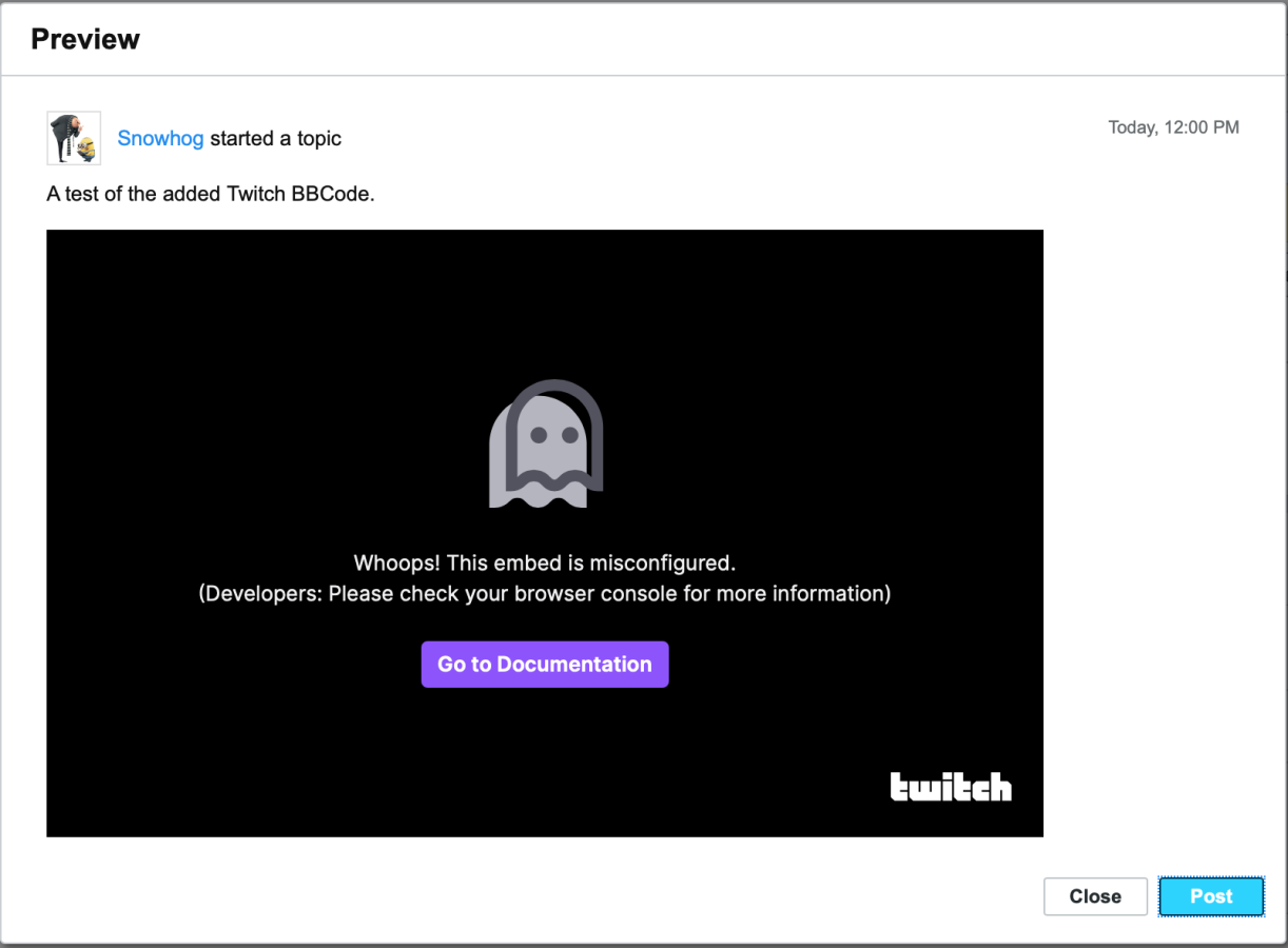

          Did that, and then tested the BBCode. It didn't work. This is the resulting error screen:
Name:	Screen Shot 2022-08-07 at 12.00.13 PM.png
          This is the Replacement code I'm using:
          <iframe src="https://player.twitch.tv/?video={param}&parent=https://www.kubuntuforums.net" frameborder="0" allowfullscreen="true" scrolling="no" height="378" width="620" style="max-width:100%;"></iframe>
            Remove the https and www in the parent parameter. It's supposed to be just the domain name which kubuntuforums.net in your case.
            My Amazon Affiliate Link ​
              Hello Glen, I got rid of the www and https, and it still give me an error saying the embed is misconfigured. I got a broken screen icon with a sad face.
              This is the code that I used:
              <iframe src="https://player.twitch.tv/?video={param}&parent=pctechforum.net" frameborder="0" allowfullscreen="true" scrolling="no" height="378" width="620" style="max-width:100%;"></iframe>
