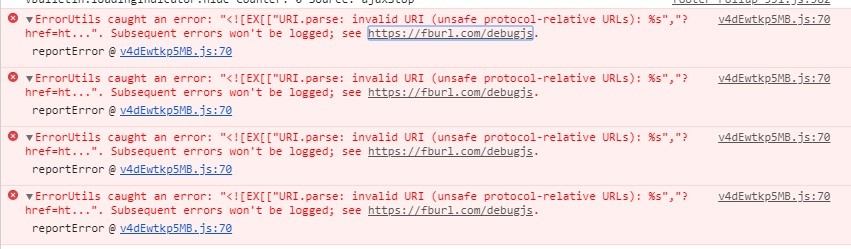

              So with that fixed, I did notice one last error that I am getting in the dev console upon embed, it does not seem to cause any issue in functionality but would be nice to remedy for the sake of completeness I guess. The error is as per the below screenshot.

              I did try navigating to the link https://fburl.com/debugjs, but all I get is a page cannot be found on FB's end . Has anyone seen this error before ? An easy fix ?

                Those are errors on Facebook side. I wouldn't worry about those if they don't affect or cause any issue on the FB embed.
                  Awesome, if it ain't broke don't fix it right ! Thanks for the input.
