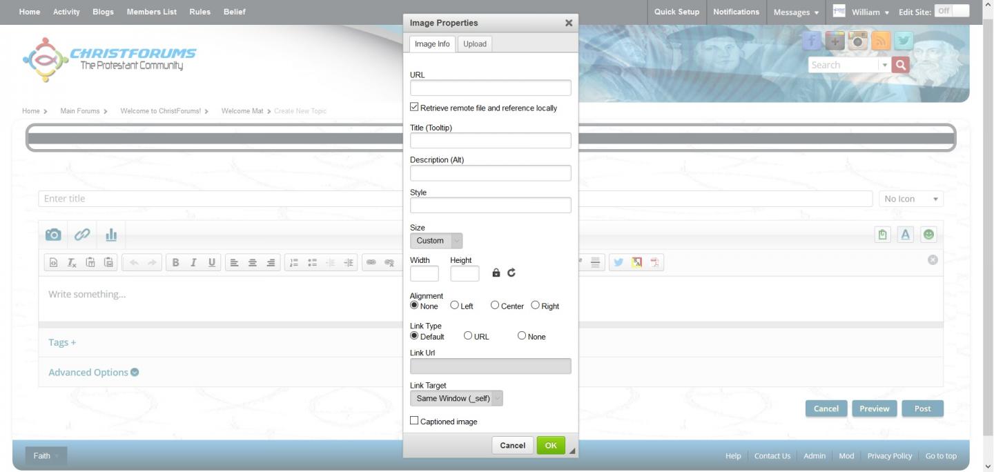

    Is there a way to auto-check the "Retrieve remote file and reference locally" check box? I run a SSL site and it is really annoying when someone attaches a non SSL image and does not check the box. The SSL then breaks because of mixed content. It would be a great customization to be able to auto check this option:
Name:	SSL Image Proxy.jpg

    Glen can probably do better at this one, but I've done a little footwork.
    The checkbox element is part of the CKE.
    <input class="cke_dialog_ui_checkbox_input" aria-labelledby="cke_88_label" id="cke_89_uiElement" type="checkbox">
    The ID for this checkbox is "cke_89_uiElement"
    In order to change the box to checked by default, checked> has to be added to the end of the <input
    I know of 2 ways to do this.
    1. Hack the code and set it. The issue I have is that I don't have the same version of vB and can not find that new code.
    It is most likely not in the vB core folder and more likely in the root/JS/CKEditor folder.
    2. Use jquery code to toggle the box as checked.
    $(document).ready(function() {
        $("#cke_89_uiElement").click(function() {
            var checkBoxes = $("input[name=recipients\\[\\]]");
            checkBoxes.prop("checked", !checkBoxes.prop("checked"));
    This could be added to the footer module, I think, to trigger it.
    All I have for now, but you should be able to find either the <input line or use the code to accomplish this.

      Thanks for your input and help Felix. However, way beyond my ability.

        Okay, in the ckeditor-rollup-524.js file around line 572 I found the only occurrence of cke_dialog_ui_checkbox_input
        g={"class":[B]"cke_dialog_ui_checkbox_input",type:"checkbox"[/B],"aria-labelledby":d};t(c);a["default"]&&(g.checked="checked");"undefined"!=typeof c.inputStyle&&(c.style=c.inputStyle);
        f.checkbox=new CKEDITOR.ui.dialog.uiElement(b,c,e,"input",null,g);
        Nowhere however in the code, CKE or vB, can I find cke_89_uiElement
        This leads me to believe it is theme specific.
        If I am correct, then you would have to search your own theme code for
        and replace it with
        <input class="cke_dialog_ui_checkbox_input" aria-labelledby="cke_88_label" id="cke_89_uiElement" type="checkbox"[B] checked>[/B]
        Option 2,
        AdminCP, Styles, select your theme, edit templates, edit the FOOTER template.
        Scroll down to the end of the code and look for {vb:hook footer_before_body_end}
        Somewhere after that line add this code
         $(document).ready(function() { $("#cke_89_uiElement").click(function() { var checkBoxes = $("input[name=recipients\\[\\]]"); checkBoxes.prop("checked", !checkBoxes.prop("checked")); }); });
        Save, load up a page, try attacking an image and see if the box is checked.
        If yes, yippie!
        If no, remove the code and let us know.
        • William
          The first option had no results searching the templates. So I tried option two, cleared cache and it made no difference. Unfortunately, the option was not checked.
        Option 2 should be done via template hook to avoid editing footer template.
