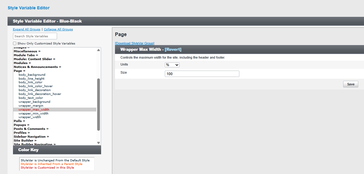

                  I have a vb6 cloud forum and I found the the wrapper_max_width under "Page" rather than "Global" The variable was set to 1200 px. I changed to px setting to % and the value to 100.
                  Click image for larger version  Name:	image.png Views:	0 Size:	50.8 KB ID:	33638
                  This worked like a charm. Thanks Glenn! I had read on the vbulletin forums that it was inadvisable to do this as it might cause problems for mobile devices, but it works fine on mine and no complains from the masses.
