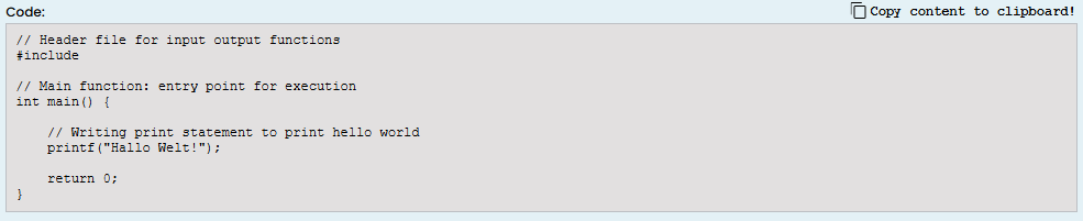

    When using HTML On in a post you will get strange behaviour for the following code tag
    // Header file for input output functions
    #include <stdio.h>
    // Main function: entry point for execution
    int main() {
        // Writing print statement to print hello world
        printf("Hello World");
        return 0;
    In my case only this is shown:
    Click image for larger version  Name:	image.png Views:	0 Size:	12.9 KB ID:	33843
    So "<stdio.h>" is missing, although it is still there. This cannot be reproduced here on vbmods.rock since HTML On is not allowed for regular users.
    It seems that vBulletin interpretes HTML also inside the code tag, what shouldn't happen in my opinion.
    Any suggestions or comments?​

      I have asked this on vbulletin.com and got the following answer from Wayne Luke.
      The system is processing the unknown HTML of <stdio.h> and the browser is processing it as HTML. vBulletin isn't altering the code. It seems that the definition in of the <pre> tag changed along the way so that code can be interpreted inside it. No C code is being interpreted or processed. The only workaround that I have at this time is to replace < and > with &lt; and &gt; respectively.
      Though, I also consider this a bug and the system should perform these replacements automatically if HTML is enabled.
      I also kindly asked him to bring this to their bugtracker.​
        I'm posting this while HTML is on.
        #include
        int main() {
            return 0;
          I can confirm the issue is reproducible when HTML is on.
