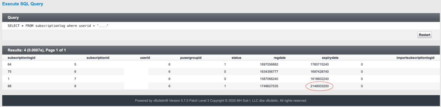

Need to change an expirydate in subscriptionlog table
Name:	Screen Shot 2025-06-09 at 10.50.05 PM.png
    The circled expirydate is incorrect. This happened because the Paid Subscription for this level (8) was set to expire in 28 years when it was established. I didn't catch that, and a Paid Subscription at that level was purchased on May 30, 2025. For the user, it was set to expire on Sat Jan 02 2038 00:00:00 GMT+0000!
    I've corrected the expiration date via the Paid Subscription Manager, but now I need to fix the established record.
    The expirydate should be: 1780181535 (Sat May 30 2026 22:52:15 GMT+0000)
    Is this the correct mySQL query to accomplish this?
    UPDATE subscriptionlog
    SET expirydate = REPLACE(expirydate, '2146003200', '1780181535')
    WHERE subscriptionlogid = '88';
    Never mind! Just realized I can edit the Paid Subscription in AdminCP > User Manager. Doh!
      Glad you figured it out.
    I would still like confirmation that the mySQL query I indicated is correct, and would have made the change too.
      That looks correct but it's always preferred to do it in the UI if available. Running SQL script directly has risk and it's recommended to back up the database first before running a query.
