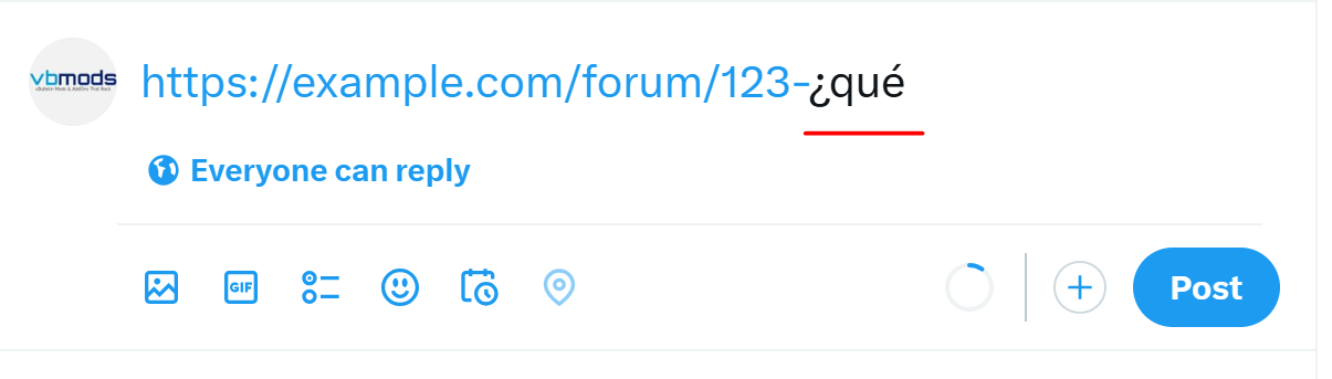

            The issue is Twitter seems more strict than Facebook with accented characters in the link being shared and requires those characters to be URL encoded. The workaround is to not use the Tweet button in the postbit and just copy the topic URL from the browser address bar and then share it manually to Twitter.​ It seems that when copying the topic URL from the address bar, the browser automatically URL encodes the accented characters in the copied link.
            If the link to be shared on Twitter has accented characters and if those characters are not URL-encoded, then Twitter cuts the link up to that character.
            This is not an issue with the mod as the mod does what it's supposed to do which is to generate the <meta> Open Graph tags.
              For example, notice how Twitter cuts the link starting from the character ¿
              The encoded URL to share for Twitter should be:
              https://example.com/forum/123-%C2%BFqu%C3%A9
