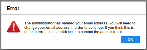

      The complete Error pop-up reads:
      Error
      The administrator has banned your email address. You will need to change your email address in order to continue. If you think this is done in error, please click here to contact the administrator.
      This is the image of the pop-up error:
