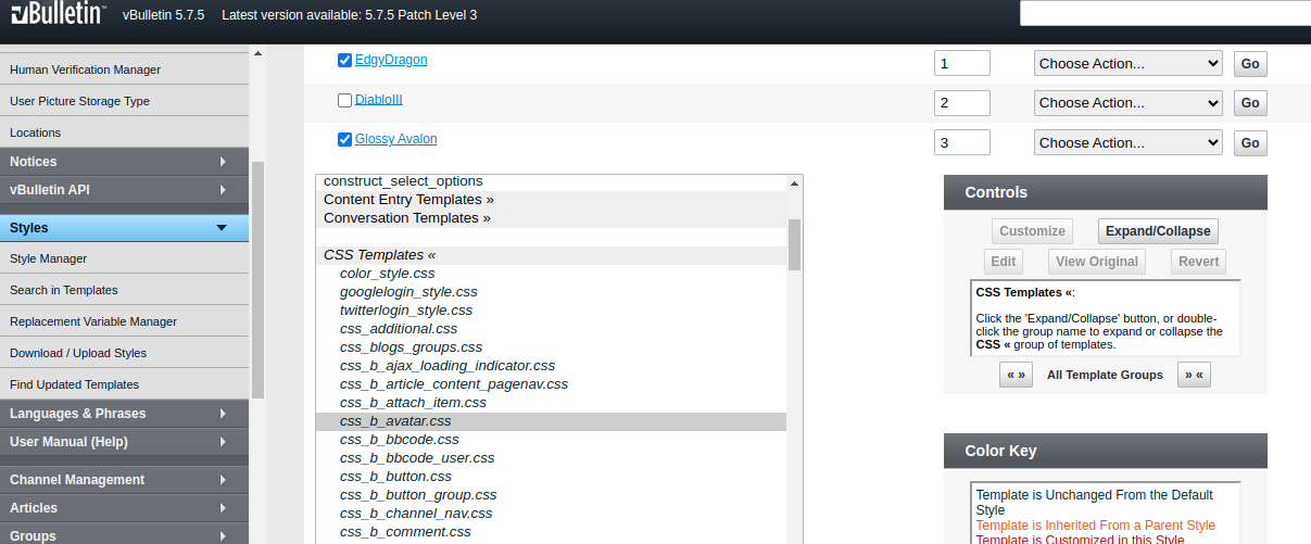

    First I would like to create a theme, I have an idea on mind on things I would like to try, but I donΒ΄t know where to go to edit things. I read that to edit css is in CSS Templates, but from there I donΒ΄t know the css I should modify and the ids of what I want to modify (maybe looking on the developer tools of the browser).

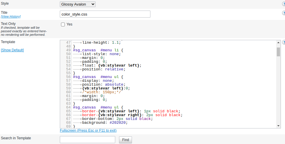

    For example, what does it mean {vb: stylevar left} ? I have seen some css files and is common to find that kind of codes.

    This is a tutorial video made by vBulletin on how to customize the forum using stylevars. This video was made 11 years ago. Although it was for an older vB5 version and it was using Firebug, you can still follow the same principle using Chrome's built-in DevTools (debugger/inspector).
    If there's no stylevar associated with an element, then you can use your own custom CSS in css_additional template.
