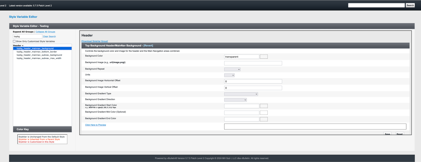

    What Style Variable is this? I tried changing topbg_header_mainnav_background to transparent, but it doesn't do what the above does.

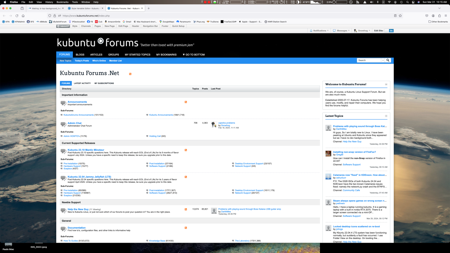

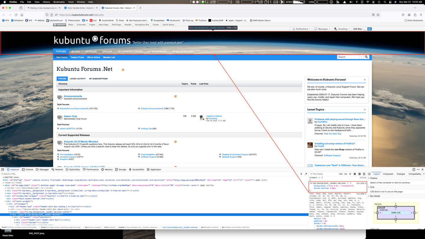

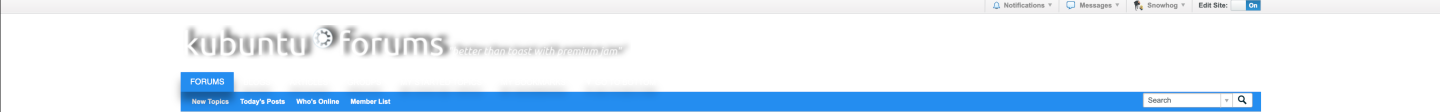

      topbg_header_mainnav_background is the style var, but changing the background color to transparent doesn't make the container transparent unless viewing the page in Inspector, and I don't understand why. I can change the background color to any other color and the container reflects that color change.​

          I am using the right style/theme. If I set a background color in topbg_header_mainnav_background and save, that color is reflected on the sites main page. If I set topbg_header_mainnav_background to transparent, it isn't reflected on the sites main page.

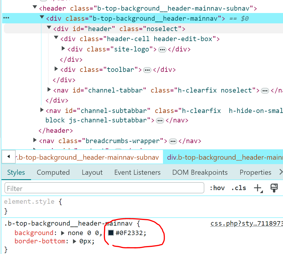

          Regardless of the background color value I set, looking at the sites main page with Inspector, the element (?) .b-top-background__header-mainnav is transparent.
            If you inspect the .b-top-background__header-mainnav element and see that the background is set to transparent (and its parent element also has transparent background set), then you should see the body background image through it.
              Right now, I'm seeing the background as #0F2332 and not transparent

                But even though it is set transparent, the background image doesn't show through it, again, unless viewing the page with Inspector.

                    to css_additional.css (no other coding), .b-top-background__header-mainnav still shows a black background when looking at the site, but is transparent when viewing the site with Inspector on.

                              But if you view the page with Inspector, you see what is shown in image 2 in post #3. There is image content that should show....Wait! I'm seeing something I didn't see before.
