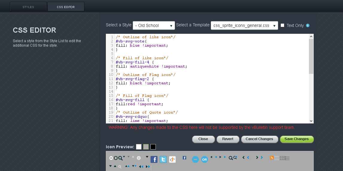

          hi Num Num can you elaborate where they go the code "css_additional.css" ?
          a little tutorial will help the newbie
          nice job like the color button
            Sure.
            In the site builder/style/select css editor/css_sprite_icons_general.css.
