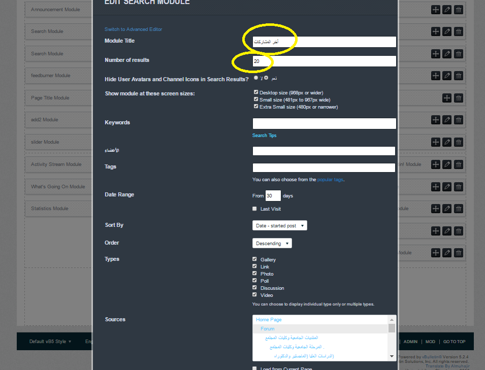

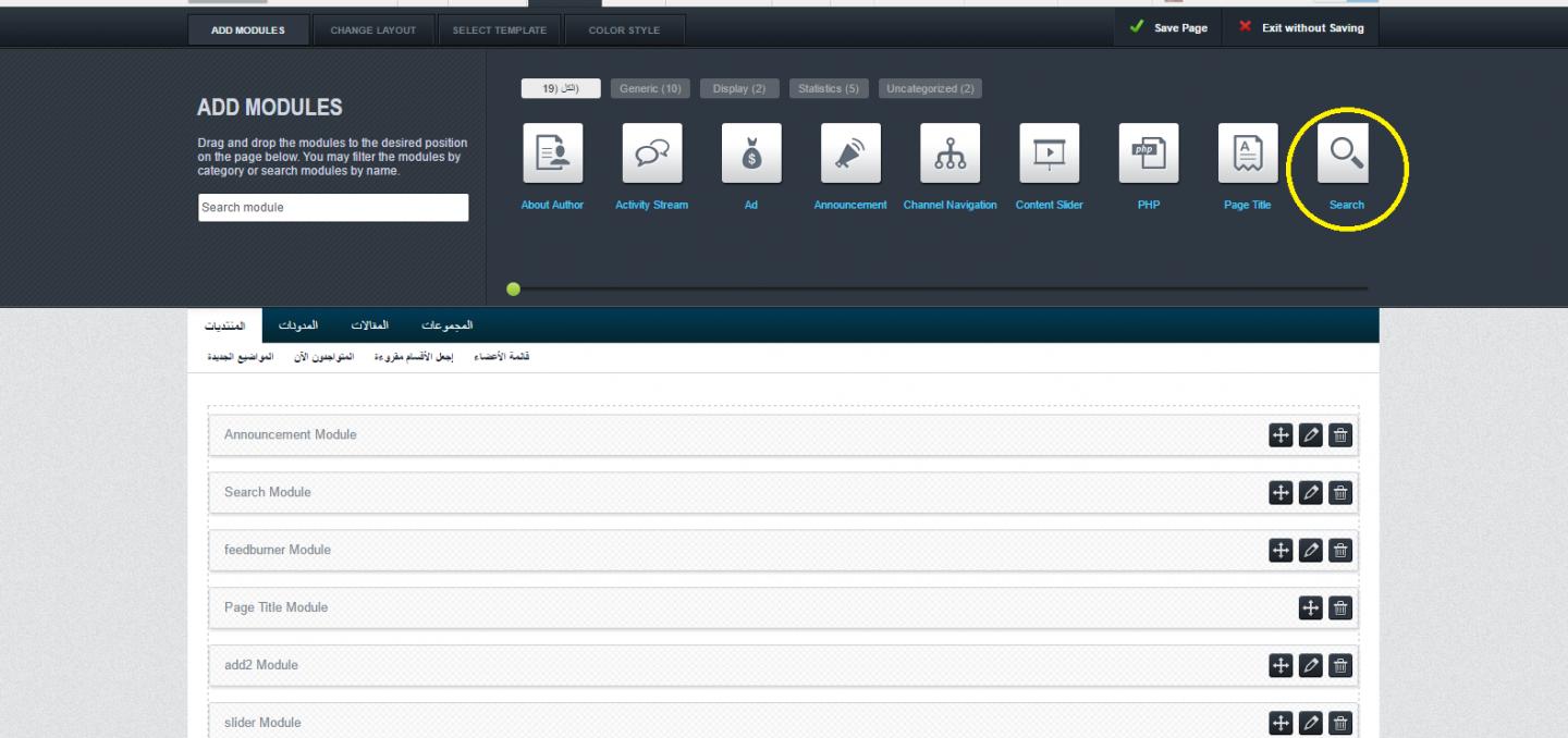

        1: Edit Page from the top
        2: edit search module drag and drop were you want to add
        3: save every thing

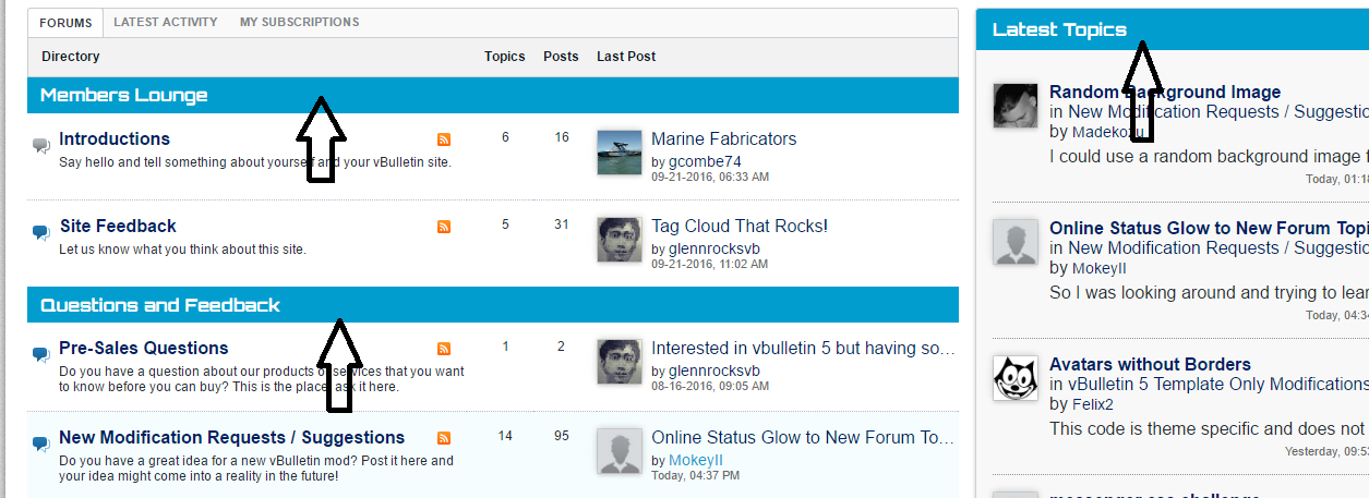

          يمكن ما فهمتني يا اخي انا محتاج اعمل الأقسام مثل الى باللوم الازرق في الصورة الاولى
            English only please.
            I think this is what you need:
            .forum-list-container .category-header {
               background: #019dce;
            .forum-list-container .category-header . category {
               color: #fff !important;
            Just add that in css_additional template.

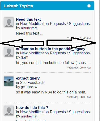

                  What to put in CSS aditional to also change the text color of categories to white?
                  What is the code to change also for the modules in the right?
                    Post a screenshot of what you are looking for and I will write you a needed code here.

                      Hello,
                      The above code it is changing the category background color. And that's it.
                      I need also the code for changing text color of categories to white (Primary Module Subheader Text Color ) and the code for changing the background and text color of modules (Module Header Background and Module Header Text Color).
                      For the moment I did it by changing the templates but I want to make it by CSS additional.
                      See the printscreen attached.
