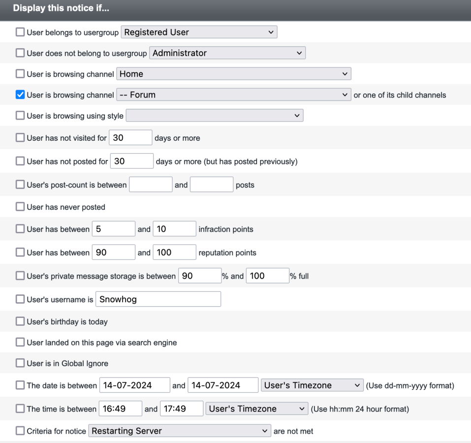

    The options provided in Notices Manager doesn't allow for selection/identification of Channels you want to exclude. This is important, as the control here is applied at top levels and as such, applies to all Channels contained therein.
    Can the ability to either select/mark (ideal) or specify by Channel Node ID (cumbersome) be done via CSS (ideal) or by a MOD (less ideal)?
Name:	Screen Shot 2024-07-14 at 4.49.51 PM.png
    Checking if a pure CSS solution is possible. It's possible using a mod with combination of JS and CSS.
      Ok, I think this would work.
      Start by setting the "User is browsing channe" option to "Forum". This basically shows the notice to all forum channels.

                  value="20" is our Archives section which contains three visible Channels. id="5" is the Notice I don't want shown in this section.
                  Using this CSS, that Notice stops being shown throughout the entire Forum. Not what I want.
                    To confirm, you want to only show the Notice with id=5 to Archives category whose nodeid=20 and to all its child forum channels and subchannels?
                      No. Without the CSS this Notice is shown to “all users who are browsing channel Forum or one of its child channels.” That’s the issue. Archives, as a section, hierarchically falls under Forum. I don’t want this Notice shown to anyone who is browsing any channels that we have in Archives. This notice isn’t applicable there.
