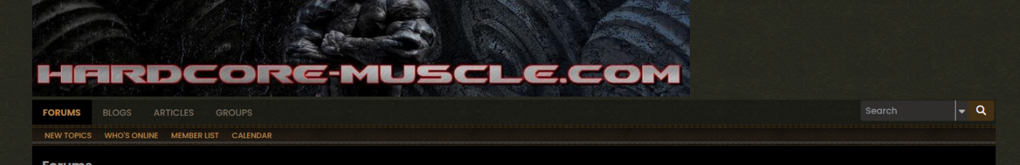

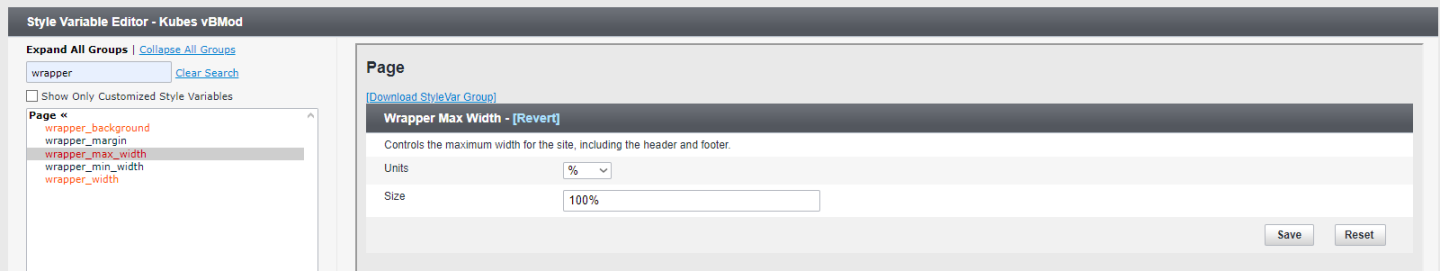

    • i am running Vb 6.0.3 and used your code to move my search box out of the header to the nav bar. I got that to work but i want my header to cover the entire top of the screen and it doesnt. I have set my Wrapper max width to 100% and used this code for the search. i would like the site logo to stretch the width of the screen? Even if i shrink the wrapper max back to 1200px the header falls a little short of covering it but i like the forum much better covering the entire width of the screen. Would just like the header logo to match the full width.

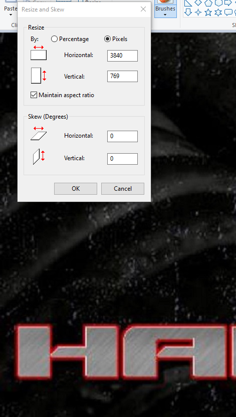

          I switched it back to center the search box the way i had it before. No matter what i size the image to Vbulletin is resizing it to 1024x205.
          Click image for larger version  Name:	image.png Views:	0 Size:	372.3 KB ID:	29949
            The only way i seem to get the banner to cover the forum is if i move the Wrapper max width back to 900 PX but i do not like that look of the forum. Any ideas? i could probably load the header as a background image and just remove the header logo?

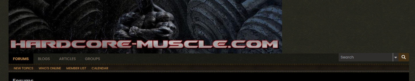

                      I tried this and it is 3000px wide and it just shrinks it
                        I even doubled it and loaded one that was
                          Then I think the system is resizing the uploaded image based on the configured maximum size in the Attachment Manager in AdminCP.
