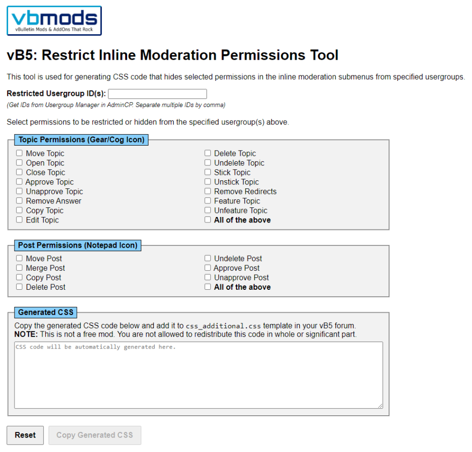

                      I created a simple tool to easily generate the CSS code with just point and click.

                        Perfect one, but it's missing "merge topics"
                          I will add that.
                            I like this new idea. Much more controllable than my version. I think I'll upgrade once it is ready
