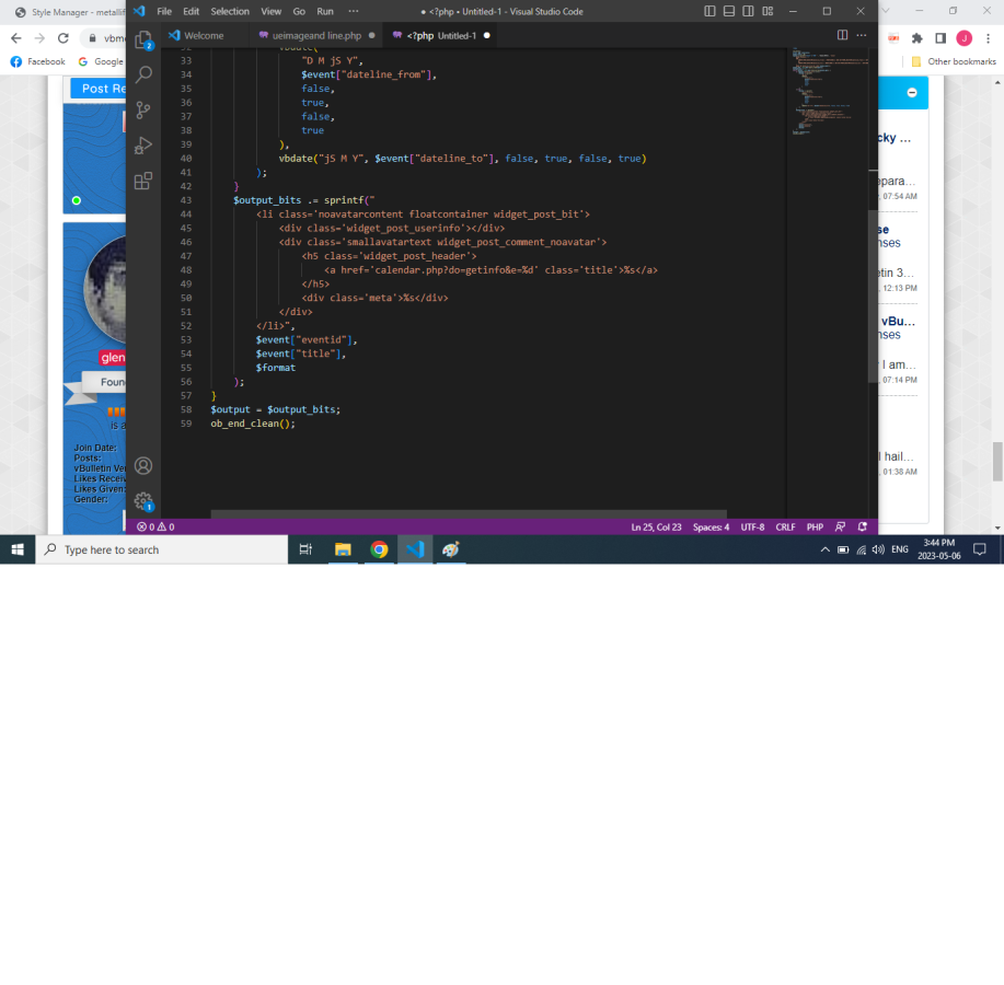

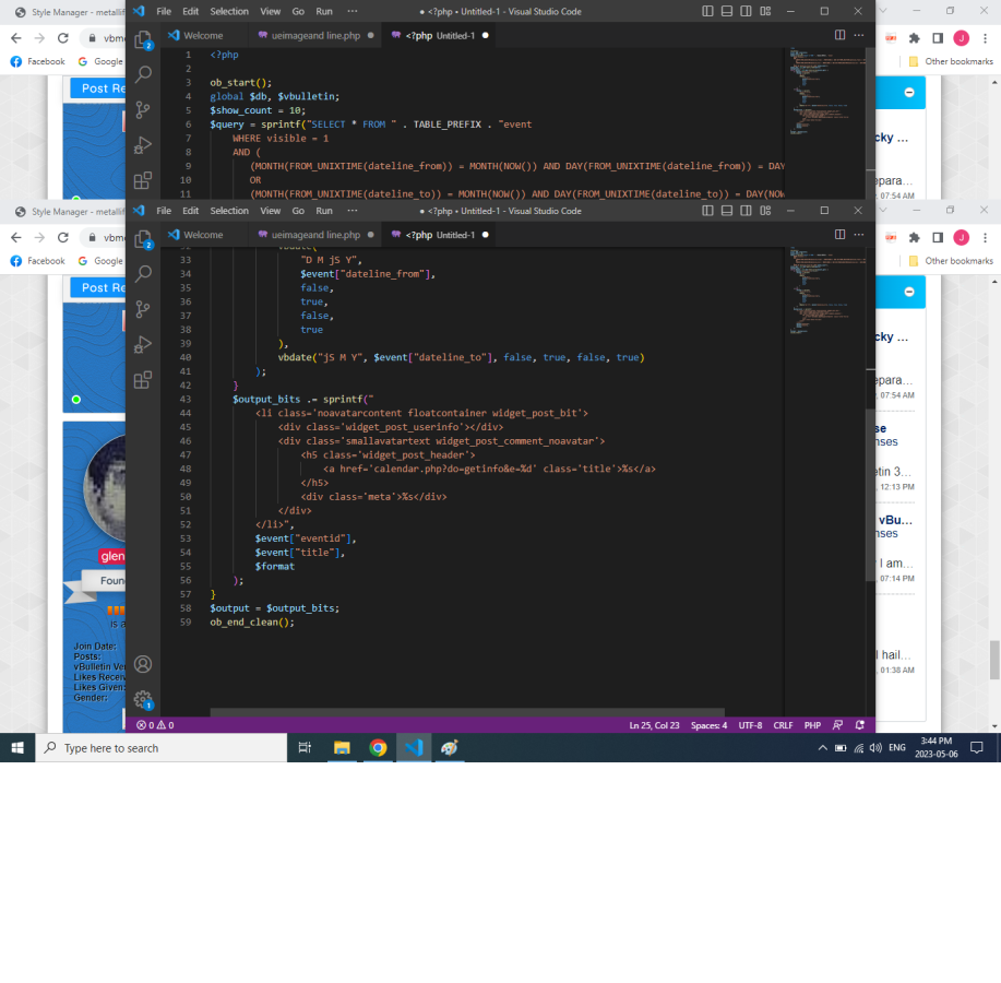

                      #55
                      Do you see which line in the code has squiggly underline in the Visual Studio Code editor?
                        #56
                        not sure, see attached..

                          #57
                          Try removing the <?php in the first line of the code. I think vB4 already has its own and doesn't need another one.

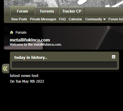

                            No errors with the removal of that code you suggested, but I got this format error and it wiped out my other block.

                              #59
                              I would need access to the forum to see what's going on.
                                #60
                                check your PMS
