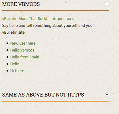

    As title suggests i was actually inspired by this post SSL and PHP to find a solution to a problem i have been having with displaying rss feeds as javascript i went to a few sites that generated the javascript code and they did work after a fashion if it was a non ssl site yes fine but when it came to ssl sites not a chance.
    So i needed to find a way to do this end result created a subdomain ie:
    https://feeds.subdomain.com
    And created the javascript from there and bingo result in piccys
    Click image for larger version  Name:	vbm.png Views:	2 Size:	497.0 KB ID:	2891
    So thanks for the inspiration

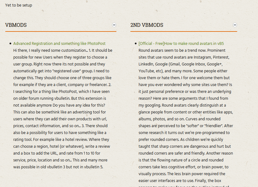

      I have acually made it a live feed page on my site which is so much easier to do now than it was back in vb3.x.x days i have put a couple of feeds from here as a demo.
      If you want to have a look it is https://cometbar.co.uk/feeds
      I will using it mostly for security threats like virus/malware stuff like that.

              The problem was.
              <script language="JavaScript" src="http://feed.cometbar.co.uk//feed2js.php?src=https%3A%2F%2Fvbmods.rocks%2Fexternal%3Ftype%3Drss2%26nodeid%3D164&chan=y&num=5&utf=y"  charset="UTF-8" type="text/javascript"></script>
              <noscript>
              <a href="http://feeds.cometbar.co.uk//feed2js.php?src=https%3A%2F%2Fvbmods.rocks%2Fexternal%3Ftype%3Drss2%26nodeid%3D164&chan=y&num=5&utf=y&html=y">View RSS feed</a>
              </noscript>
              if you look at the http:// this should be https:// so the above code did not display because the ssl cert disabled it with the error mixed content yet the
              <script language="JavaScript" src="https://feed.cometbar.co.uk//feed2js.php?src=https%3A%2F%2Fvbmods.rocks%2Fexternal%3Ftype%3Drss2%26nodeid%3D164&chan=y&num=5&utf=y"  charset="UTF-8" type="text/javascript"></script>

              Worked just fine as seen in pic
