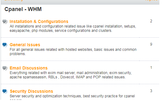

    Hi Guys how to change the channel icons in the forum.
    Please help.
    I have to change this icons:
    See below screenshot:

          glennrocksvb I have read previous the post for changing icons, however I am a little unsure in regards to having different icons for each channel, in regards to finding the channel ID, should this just be located with the inspect page function, or should I be looking else where, I am kind of new and learning, sorry if a noobie question currently need four channels with different icons.
          To quote this in bold -
          /* forum icon for forums with old posts (default) */ .forum-list-container .forum-item[data-channel-id="114"] .cell-forum .icon { background: transparent url("http://your/path/to/the/default/icon.png") no-repeat; } /* forum icon for forums with new posts */ .forum-list-container .forum-item.new[data-channel-id="114"] .cell-forum .icon { background: transparent url("http://your/path/to/the/new/icon.png") no-repeat; }"
            You can find the channel id when you inspect the page but you can also find it easier in AdminCP > Channel Management > Channel Manager.
